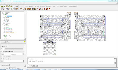

Can ICEM simply show the tetrahedral lines of the mesh on a cut plane without
shadows,
lighting,
cells from the back of the cutplane,
coloring by quality
Just the lines would be grand. No colors. No shading.
Rather than this:
can it produce this type of view?

Almost! Thanks! I still see the interior and the mesh on the back side.

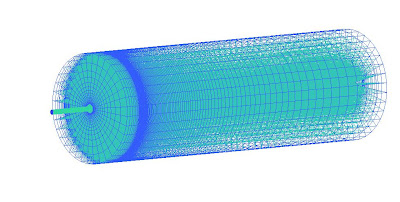

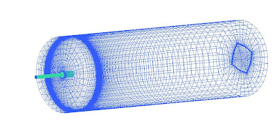

I acknowledge that I mentioned Tets in the original post, but in actuality it applies to any 3d mesh. There is the choice of two types of mesh display more or less:
solid: (solid/wireframe)
which is nice because there are no visible interior or backside cells, but there's the (in my case undesirable) shading and the lighting.
The wireframe views look like these (with and without volume meshes):
which is nice because of the absence of lighting and shading effects, but the interior and anterior cells are visible.
Can I turn off lighting, even if only for pictures which I save? Or can ICEM display wireframes of only the cells in the foreground?
I'm flexible, actually. The display could remain the same, no problemo, if the postscript output would only show wireframes of the visible cells and no shading/shadows etc.
Any tips? Solutions which include modifying the postscript with a text editor are also very welcome.
