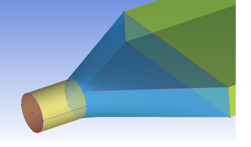

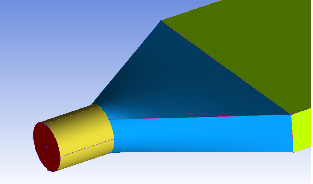

Hi ALL,
I am trying to mesh a geometry with hex dominant cells, Please go through the snaps I have posted here.
I have a cicular pipe on one end and a rectangular cross section box on the other end. The transition is from a circular cross-section to a rectangle. Hence there is a planar diffuser in between. I am trying to mesh this geometry using the blocking method in ICEMCFD.
Geometry
http://i1228.photobucket.com/albums/...CEM/Geo1-1.png
http://i1228.photobucket.com/albums/.../ICEM/Geo2.png
Premesh
http://i1228.photobucket.com/albums/...EM/Premesh.png
Blocks with O-grid
http://i1228.photobucket.com/albums/...idBlocks-1.png
Hex Cells - Mesh Quality - Aspect Ratio
http://i1228.photobucket.com/albums/...spectratio.png
Hex Cells - Mesh Quality - Quality
http://i1228.photobucket.com/albums/...EM/Quality.png
I am getting very high aspect ratio hex cells in the transition part, Can anyone assist me in having a better quality mesh. I could not figure out a way to mesh it properly in the diffuser part.

I am quite new to Icem but I'll try to help.
It looks to me that ICEM is not correctly placing the nodes on the O-Grid internal edges. It can be more clear if you would:
right click on Pre-mesh>Scan planes
then you should swap the planes and find out what is going on inside it.
I can guess some solutions... but keep in mind that I am not an expert:
1)Extend the split on the first O-grid (the one in the round pipe) and connect it with the square section trough a more clean block structure. Check for example the one which ICEM does automatically when you create an O-Grid by selecting blocks.
2) Simply move the internal vertices around and see what happens
3) Use a different law for the nodes on the internal edges.
I hope that this was helpful.

Sorry, your topology is wrong and then you didn't fit your bad topology before creating your Ogrids...
Lets look at topology first...
You said it yourself, it is just a pipe with a transition... Therefore you just need a pipe type topology...
Create a single block for the length of the pipe... Associate the ends of the block to the ends of the pipe... (one end is associated to the circle, the other to the square at the opposite side...)
Then split the block twice across its length... Associate these new splits, one with the circle on the one side of the transition and the other with the rectangle on the other side of the transition...
Actually snap fit these verts into place before creating the Ogrid... The quality will already be decent except for the "corners" of the round pipe.
Then apply the ogrid... Select all three blocks for the Ogrid, also select the inlet and outlet faces... Apply.
Now your blocking is done.
Adjust your edge parameters to have the right mesh distributions, etc...
