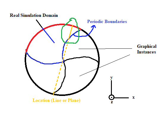

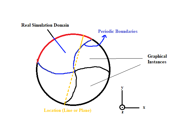

How can I insert a line or plane and plot data outside of my real simulation.As you can see in the picture below, I have done my simulation on a periodic part of my real domain. now, I want to insert the yellow line or plane which go trough my graphical instances where there is no problem in adding them but I Cannot plot the charts, data or, contour on this Line(plane) through instances. Is there anyway to do that?

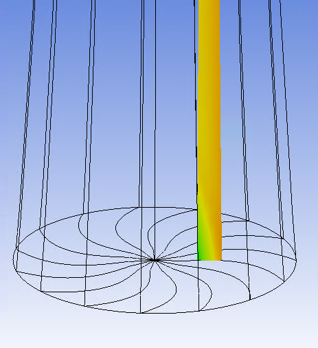

Thank you, Gert-Jan. I've done that. I made instances of my domain then inserted the plane, but I'm only getting the part of plane that cuts the simulated geometry(the green part).
something like this:

You should make the extra plane at 90° as well and perform the same trick: transform by 90°.
I guess you can also change the view of the extra plane. The definition window of (almost) every object has a 'View' Tab where you can 'move' the object, like a rotation around the main axis, such that everything is in line.
