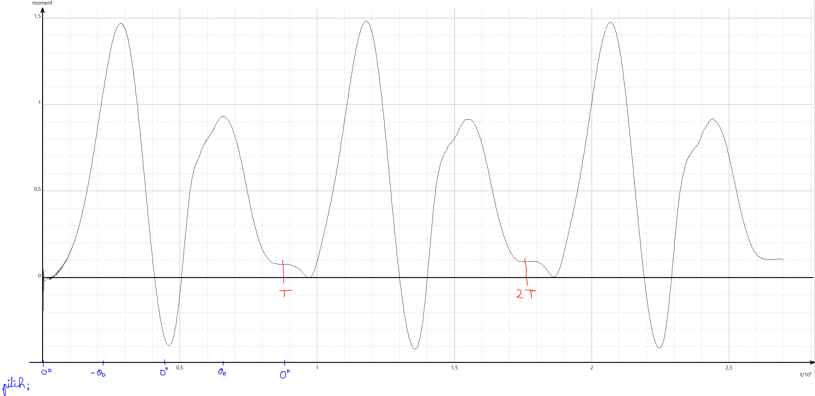

I am a French student (sorry for my English), I try to use Ansys Fluent to calculate the forces applied on a flapping hydrofoil in order to find the best propulsion parameters.
I read a lot on the Internet to learn more about Ansys, and here are my settings and model that I chose:
- Transient
- Viscous model: SST transition
- liquid water
- triangular mesh method
- dynamic mesh: smoothing diffusion (diffusion parameter = 1)
- methods: PISO (gradient: based on least squares cells, pressure: Presto, Momentum: QUICK, and others: Second Order)
The foil moves with UDF.
(omega = -theta * w * cos (w * time);
vel = ho * w * sin (w * time);
cg_vel [0] = 0.0;
cg_vel [1] = vel;
cg_vel [2] = 0.0;
cg_omega [0] = 0.0;
cg_omega [1] = 0.0;
cg_omega [2] = omega;
The time step is 0.001 s
I calculate the lifting and drag coefficients / forces and the moment applied to the foil using the tool: 'Report definitions -> Forces'.
The solution has converged but I find the results bizarre: the curve of the moments is not symmetrical with respect to the point T/2 a complete period.
screenshot
I expected it to be like that.
I think it should be symmetrical because the profile of the foil is symmetrical (NACA00012) and the pitch movement is sinusoidal.
Then I use the moment values ​​to calculate the efficiency and I'm afraid the result will be wrong.
Is there an offset value to consider? Or did I do something wrong?

Are you including the oscillations of the hydrofoil? If not, then you do not need to include any UDF or motion of the hydrofoil. Hydrofoil can be fixed in it's position and the flow is solved around it.
Assuming that the foil is oscillating, you will have to average the coefficient over time, at least over three flow-times excluding the first flow-time, where flow-time could be defined as the ratio of the chord length to the freestream velocity.

Here is more details about what I did with the force/moment results :
Instantaneous power needed to move the hydrofoil is defined like that :
P(t)=- Fy(t) * (dy/dt) - M(t) *(dθ/dt)
Then I calculate the power needed for each time step over two periods, and i calculate the mean power over one period. (I exclude the first period as you said)
And I define the efficiency as follow : η=(Fxmean* U)/(Pmean)
I have strange results and I think the problem comes from the moment calculation in Ansys (as I said in my first message), but I don't know why.

Moment calculation requires a center point to be defined. However, in you case, due to translational velocity, center of moment might be changing. What's the reason for expecting a symmetric result about T/2? Is it because the motion is simple harmonic? Results would be periodic but asymmetric and the result predicted appear to show good periodicity.

The center of moment is the origin (and the center of rotation of the foil too).
But I thought this point would follow the hydrofoil in its mouvement as the center of rotation does, but I might be wrong.
Well yes... what I said in the first message is not really clear.
I think that as the mouvement is harmonic and the profile of the foil is symmetrical, the curve of moment between T/2 - T should be the exact opposite of the curve between 0 - T/2 (+T/2 translated), as it is for the curve of lift/drag.
