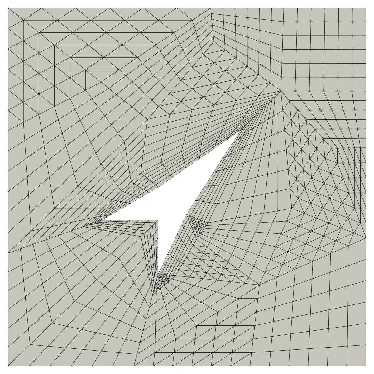

Hello OF world,
I made a mesh quality improvement / smoothing utility for OF. It moves internal mesh points by using the Centroidal smoothing algorithm (a version of the Laplacian smoothing algorithm, which uses surrounding cell centers instead of the neighbouring vertex locations to calculate the new vertex position). Optional heuristic quality control options exist to constrain the smoothing, to avoid self-intersections. No changes to mesh topology are made.
Code available at https://github.com/tkeskita/smoothMesh
Have a look at the demo video:
Cheers!
Tuomo

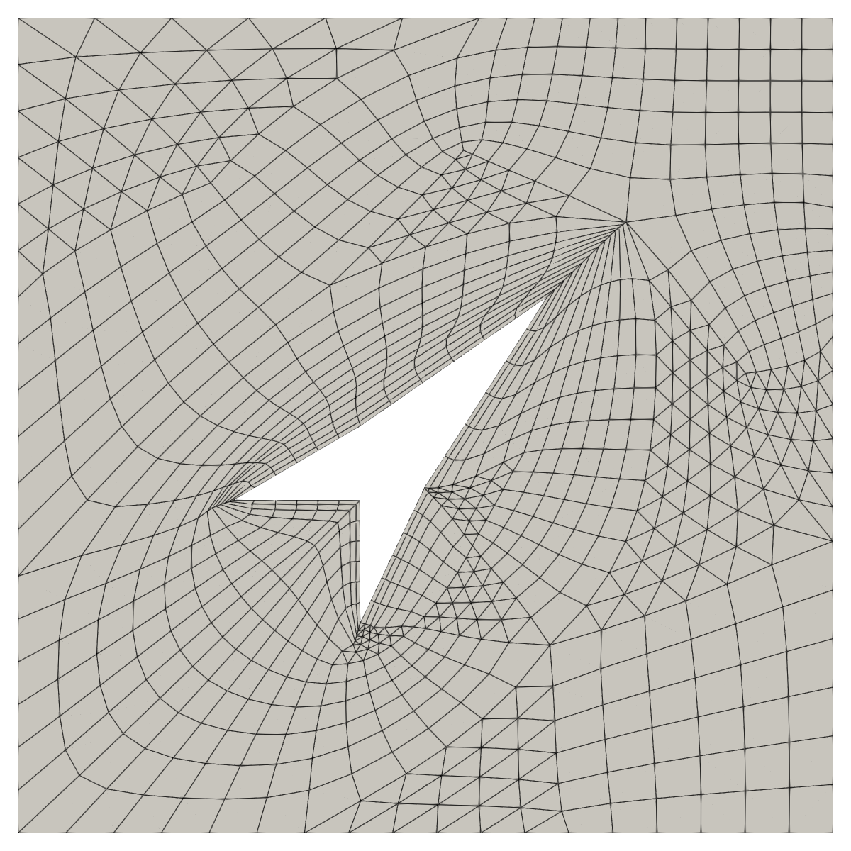

Hello OF world,
I've now reached a point where I think smoothMesh is stable. It can now also improve the prismatic boundary layers in the smoothing process. If you need mesh smoothing, please give it a go and comment in this thread how did it go. I added some run examples of a test case in the docs to show the usage. Happy smoothing!
Here's an example test mesh before smoothing:
and after smoothing:
