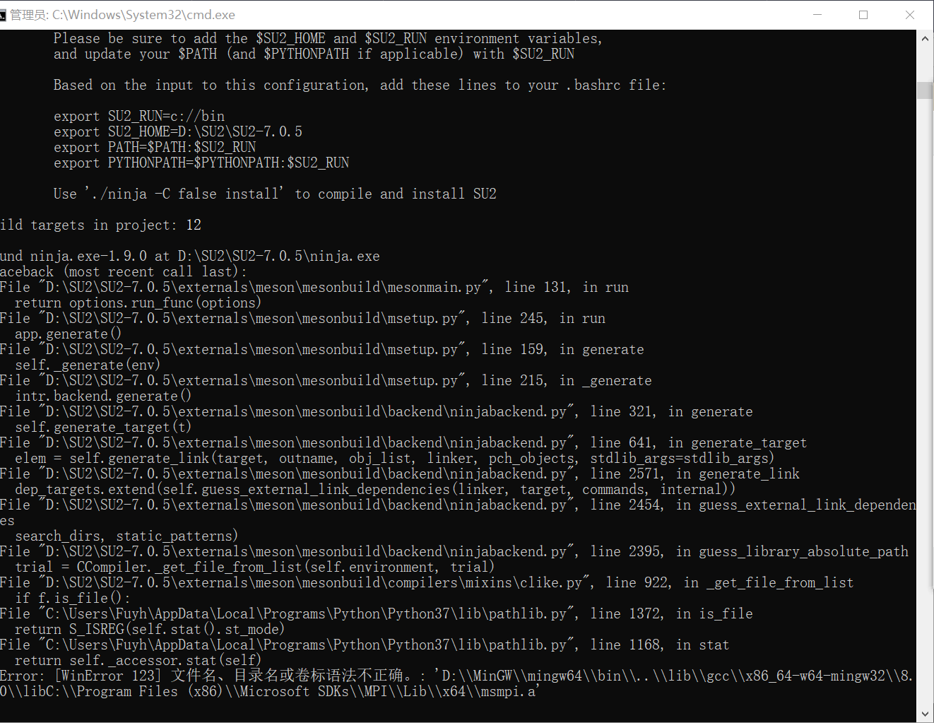

I am having trouble to install SU2 7.0.5 on Windows10 by compiling from the source code. I am trying to follow the instructions on their website. But there was a problem with the meson build.
I have installed the necessary Tools.
Now the problem is, I run Python according to the instruction of su2 official website meson.py build
The following has happened
The main problem is that the file name in the path of meson generated file is wrong. One of filenames has a ':'.
I try to find the source of the problem by following the traceback of the program. The first step is to find the source of the error file name
SU2-7.0.5\externals\meson\mesonbuild\compilers\mixins\ clike.py
line901
So I print the parameters of directory and libname, and the result is as follows,
After comparison, I think the problem is more likely to be the problem with the libname parameter. How can a libname be so similar to a file path.
Then I traced the source of the libname parameter, which was taken from the command parameter. I first printed the content of the command parameter, and then found the source of the command parameter, as shown in the figure,
SU2-7.0.5\externals\meson\mesonbuild\backend\ninjaback end.py
line2414
The content of this code was not studied, and I tried to modify something to bypass it.
line902
Try to modify the generated code of the strange file path, and directly use f = path (libname) when libname appears ":", so as to avoid [winerror 123]. Next, it can compile successfully, but when linking, there is a problem of cannot find - lC: program files (x86) - Microsoft SDKs / MPI / lib / x64 / msmpi. a
At present, the only possible way is to understand the commands generation process code, so as to find out the library with the strange name of C:\ program \iles (x86),\Microsoft SDKs,\MPI\ lib\ x64\\msmpi. a, and see if it can be modified.
Any help?
How to solve it?
Are there staff members or users who are familiar with the compilation of meson help me?
Thanks in advance!

Hello Alexander,
I am currently facing the exact same problem. Did you find a solution?
Kazunobu
