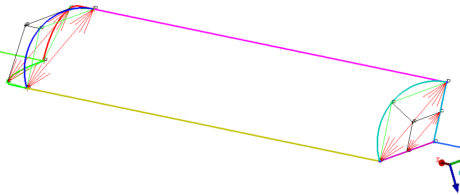

Also there's some periodic issue... I set periodic in mesh tab, then 2d surface initialization, Edit block=>periodic vertices, I made all the vertices on the periodic surface periodic. the surface is tri-paved surface. It seems that all the nodes are matched, but the elements on the surface are not, the block faces are not periodic. I think it's because type of block face is "free". How to make free surface periodic?
I had similar problem before when I tried to generate surface mesh then use Delaunay under mesh tab. Only octree give respect to periodic set up. The surface mesh generation seem ignored the periodic set up.

the periodic is designed for Octree method and mapped type face blocks
They suggested me some tricky ways to deal with free type face, I'm still trying to make it work.
My application is to fluent and it seems that fluent could define non-conformal periodic faces.
I'll try either way..
