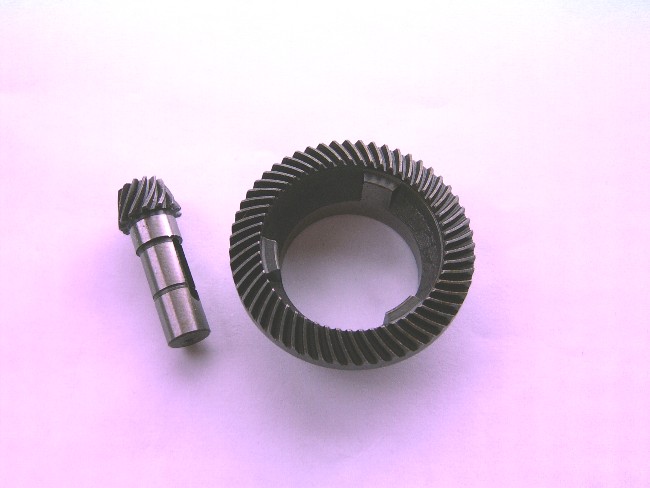

Hello Antonello,
well, I found some ways to sove this problem, depending how complicated is the geometry.
First one was the use of a software to "extract" the faces out of my complex geometry (such bevel gears: http://www.elektrowerkzeuge-ersatzte...TE704za012.JPG)
something that sHM wasn't doing properly (thus generating a lot of those "domains"). This software is unfortunately not free, but solved this problem (check CastNet, from DHCAE-Tools).
On the other hand, a more simple designed geometry from those gears could be implemented without problems, only by identifying the different domains between solid and fluid area. Fact is that the toal number of domains should never exceed the amount of specified fluid/solid areas...
Does it give an answer to your question?
