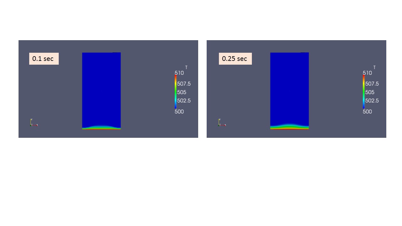

Hi fiends,
I implement Lee mass transfer model in openFoam (interPhaseChangeFoam)
and in first step I validate it by 1D stefan problem.But in 2D film boiling case
solver doesn't work correctly and mushroom shape doesn't appear and
interface going up and finally give linear shape!!!
in my case Sp=-vDotAlphal and Su=divU*alpha1
and pressure source term is +vDotp.
I put some photos of pressure + temperature and volume fraction in
different times :
Alpha or volume fraction
http://s3.picofile.com/file/82204120...sentation1.jpg
Pressure
http://s3.picofile.com/file/82204122...sentation2.jpg
Temperature
http://s3.picofile.com/file/82204125...sentation3.jpg
velocity
http://s3.picofile.com/file/82204126...sentation4.jpg

I am working with two dimensional film boiling too. I am getting so much trouble constructing the interface given by the following equation:
And the figure came out like this:
Why I am not getting the correct interface? Any idea should be appreciated.
Attachment 74090
Attachment 74091
Are you using Symmetry? if yes, then change reflect plane
