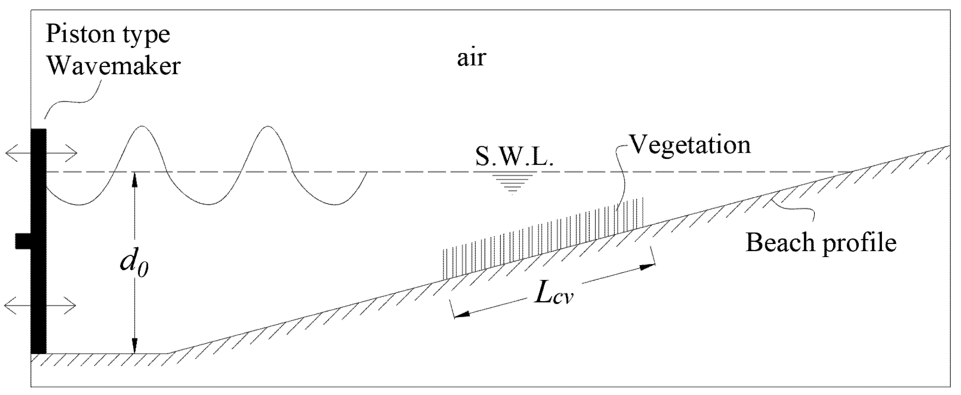

Hi! I am new to CFD. I want to use the multiphase solver and generate a beach-type geometry (box with slanted side for beach) to observe the waves on the beach. I don't know how to create this fluid. I was able to create the whole domain via BlockMeshDict but the water, I don't know how to put.
I have checked setFieldsDict but I feel like it can only create boxes of fluid. (Correct me if I am wrong). Thank you to anyone who can answer. |

Hello Yann, I am planning to create something like this.
Edit: Sorry I can't seem to upload the photo. It's basically a beach type of setup like this. |

Hello Yann, I cannot seem to upload my own photo. But it looks something like this:
https://pub.mdpi-res.com/jmse/jmse-1...png?1676882133 or maybe this https://www.mdpi.com/jmse/jmse-11-00...00519-g001.png Thank you. |

Why do you think you need something more than a box to set the water phase?
Your fluid domain should end at the beach sand ("wall"). You can use a generic box to set the water because where the sand is, you should have no cells for either air or water to exist. You might want to attach an image of your blockMesh or the blockMeshDict here so we can see what that looks like. You can attach normal picture files to any forum post here, no need for external links. |

This is what I am trying to simulate. And then maybe add water until the middle height.But then there is no water appearing.
https://imgur.com/CIXuGdJ I tried to run a case wherein it is rectangular, and the water appears. Last edited by bunnybunny; October 5, 2023 at 06:19. Reason: typo |
